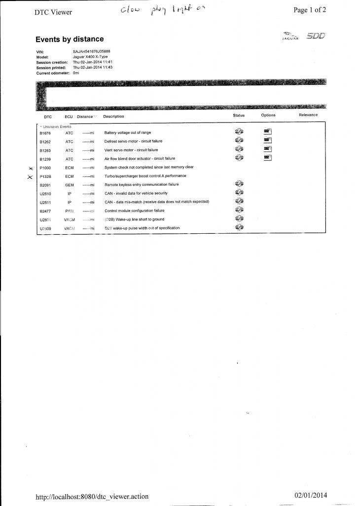

Having problems with the actuator on the turbo, the car goes into "limp home" mode and the coil lights flashes when accelerating the car in 3rd gear.  It also has a nasty vibration when accelerating beyond 50mph - this worsens to 70 then eases off after this time but then stops when foot off the accelerator. This also occurs in cruise control.
Turbo
My mechanic found the code P132B and a diesel specialist replaced the actuator before Christmas, only for the same issue to arise last week!  It went back to them and they replaced the actuator again and flushed the turbo today.  It went again on the way home today.

The code you mentioned isn't correct .... it should be P132(8?) possibly 8 or another digit?
It sounds like an injector has gone offline as the revs increase to around boost pressure.
There should really be a more in-depth diagnosis with live data to determine the actual cause of the fault when it is occuring.
If you could get back to me with more diagnostic information, that would really help.

Sorry Dom...you're right on the code.
I have done a bit of research into the fault which seems to be turbo boost related.
