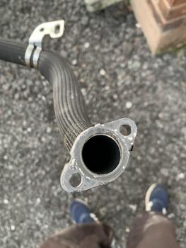

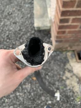

Car feels a bit better after this and I suspect the EGR temp sensors set the code due to rising temps in the EGR due to a back up of gasses. Sorry for the lack of pictures as the light was going out and I was on the driveway but this picture shows what it is like after 95000 mls.
The top end of the pipe totally clogged and the bottom (EGR end) ok. Definitely worth doing especially where they are and the design they consist of, I don’t think barely any gasses we’re getting through at times.
