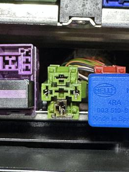

Noticed the fuel pump relay socket has some carbon marking on it (see picture). I’m not sure if this is old or recent.
I jumped the relay terminals with a paper clip to test the pump, but did not hear anything.
