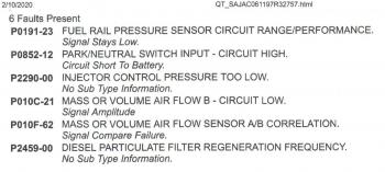

Took it to have a diagnostic and it has come up with the folloring faults in the attachments (there were a few other faults not related to the running of the car so not included them).
So my question is, any ideas what could be causeing the fault, any suggestions how to go about fixing the fault

Just been looking at some of the error codes, and the TCM error code U0401-68 seems to give the sysmtoms that we are experienceing, DSC light on, limp mode etc.
Was also wondering if the faults in the Power Control Module are historic faults, and when the garage replaced the high preassure fuel pump they didnt clear the codes ... just a thought, but I image they would have cleared the codes though ?????
So potentially should be looking at the U0401-68 fault first .. any thoughts ?
