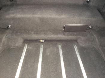

Do not fit your charger direct to the battery as you will bypass the battery monitoring system (BMS). The negative of your charger should go to a suitable ground point. Here is my, Jaguar recommended installation;
and what it looks like with the trim in place:
The charger you have will be fine.👍

The answers above are good, but my recommendation is to use the charger connected as follows:
Lift the boot floor and you will see an earth connection - looks like a threaded screw coming up from the boot floor - down on the left hand side as you look forward. Ensure you remove the paint to get a proper connection to earth / ground, fit the black clip.
Remove the vent louvre on the left hand side panel of the boot as you look forward and, with a torch, check inside and down for the battery remote positive cable, which should have its termination covered with a rubber boot. Slide the rubber boot forward, off the terminal and you will fit the red clip here.
Ensure your charger / conditioner is on the 12V setting. and switch on. There is plenty enough "give" in the boot edge seal so that the charger itself remains outside the car, with the charging leads passing over the seal with the boot lid closed.
