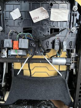

Hi all just joined the forum - I have just bought an XF and love it - always wanted a Jag and glad to have finally got one! Although I am looking to swap the interior from cream to black. I have a 2011 XF luxury 2.2td model, current interior is cream and I am swapping this for black interior with upgraded 18 way seats from the portfolio model. I have run into an issue in that the connectors and wiring is different I had stupidly assumed connectors would be the same with only the wiring different. Note not bothered about heated seats etc only want them to move!
has anyone tried this swap and got a way to connect the cars wiring to the replacement seats? Any help is appreciated cheers Dave
photo of the current seat below.

Welcome, unfortunately I think you will need different wiring loom for the electric chairs. From memory you have one for the heated seats and a seperate one for the electric chair.
It may also have a seperate fuse too for the chair.
