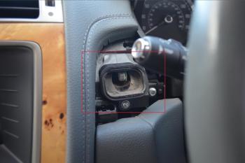

The noise is mostly likely the aspirator fan behind the dashboard. This picture shows how much dust can accumulate on the sensor part at the grill. Removing the dash surround and thoroughly cleaning and blowing out with air may help.
