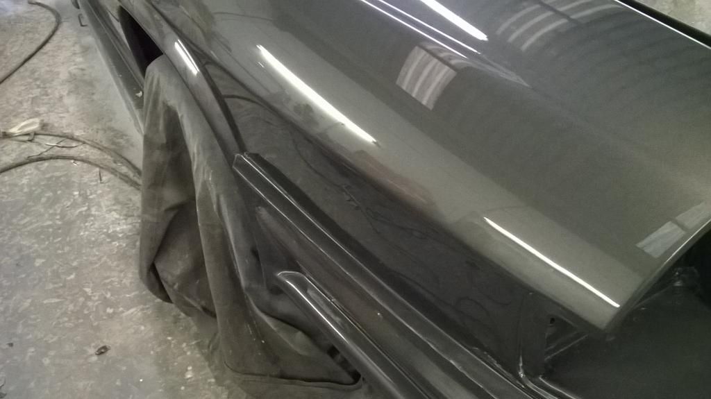

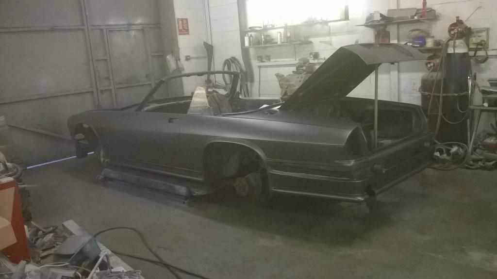

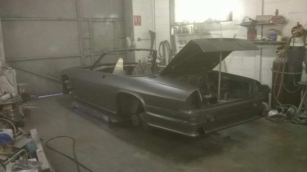

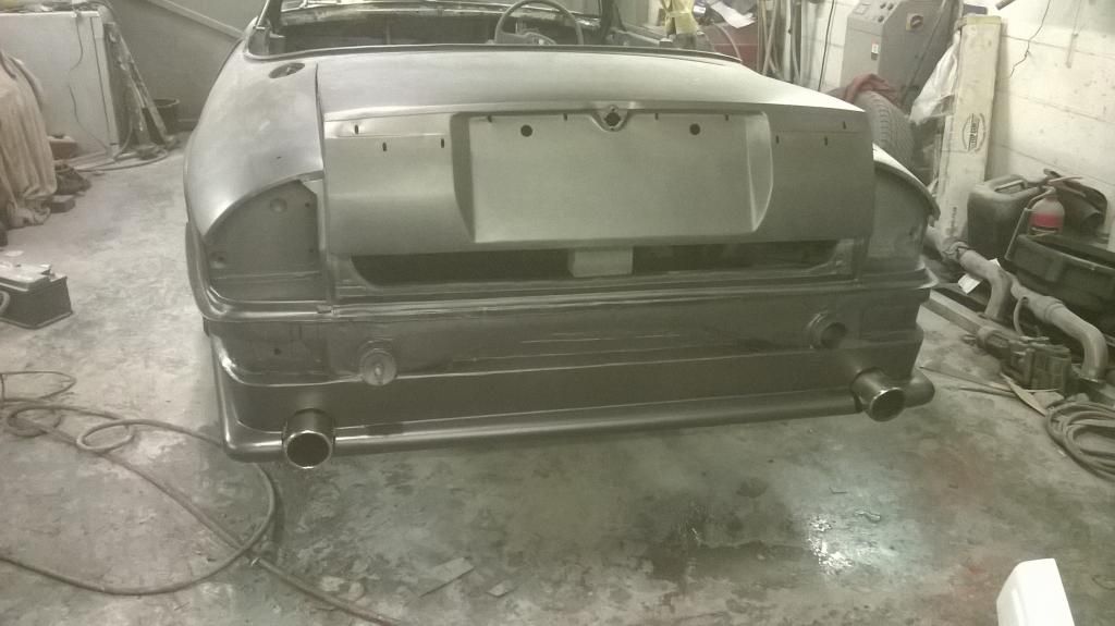

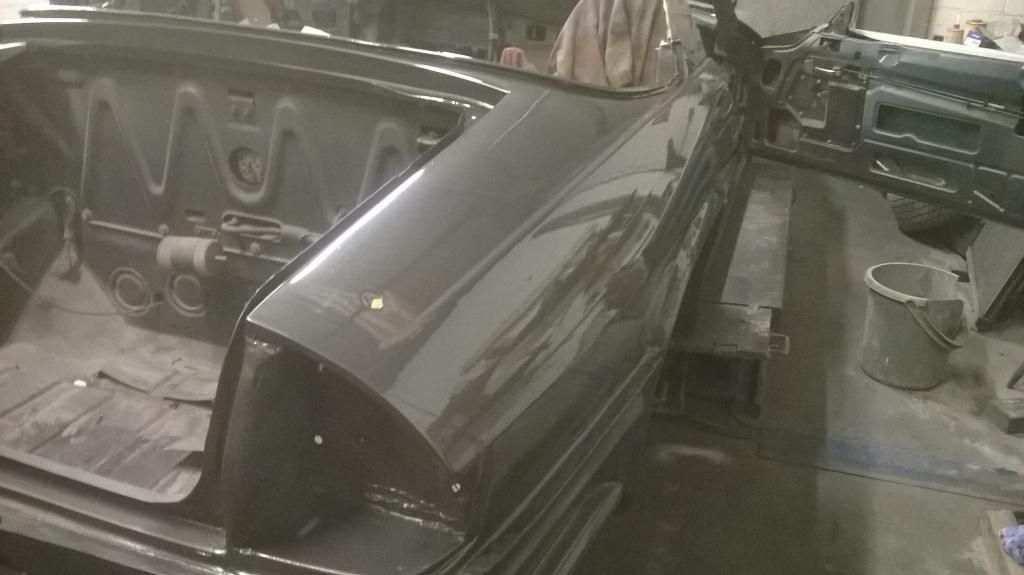

got a little further today, been running around a lot tho but new pics

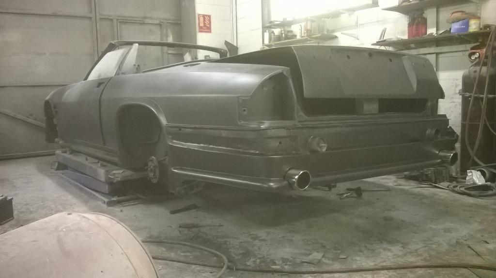

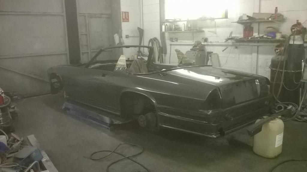

finally bodywork is done ish!
truth will be known tomorrow, i kinda threw the lacquer at it and went. no doubt i will have runs. i cleaned the place and damped it down and still ended up with dust in the clear. kinda why i went straight after lol.

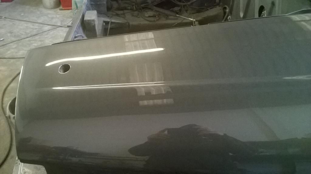

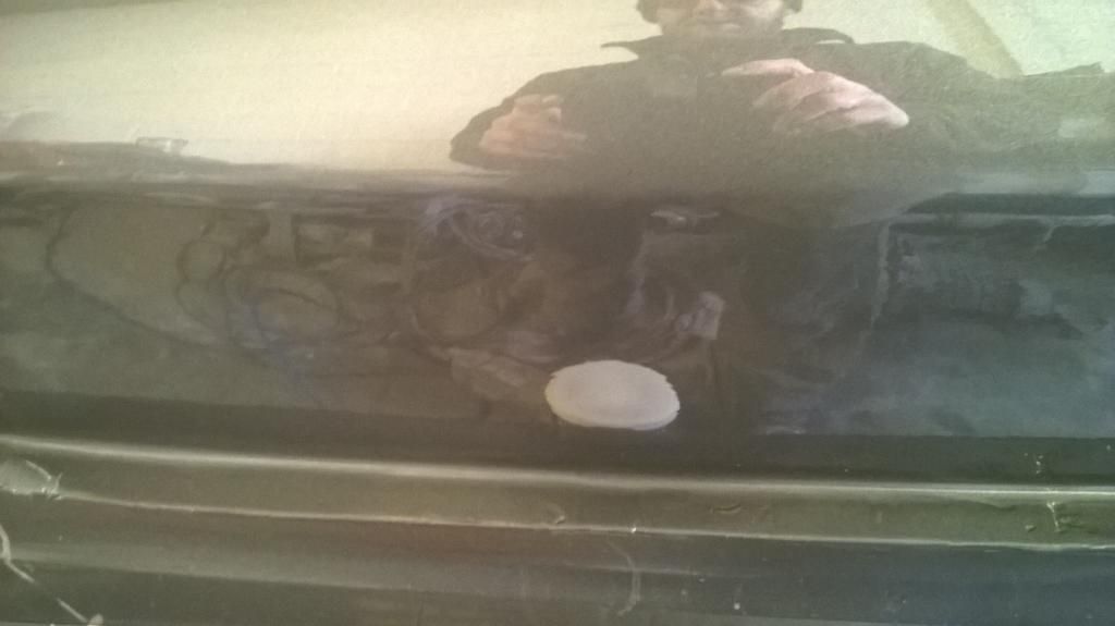

the next day shown the result.....i really need a clinical spray booth! cant afford one nor do i have the space for one.
but its just dust and a little rubbing with 1200 and soapy water and a final lacquer will fix that.
this is a wet sand and top coat of fresh lacquer today

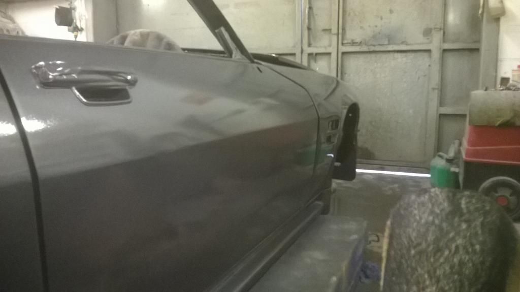

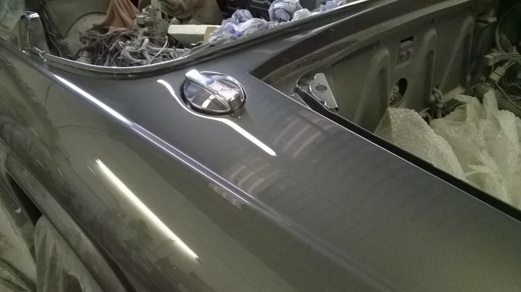

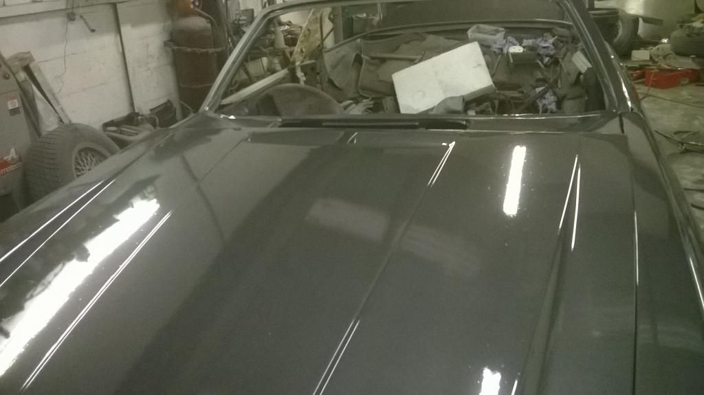

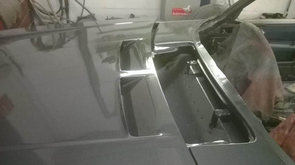

after a final wet sand with 1200-2000 and a buff, there will be no traces, the car in that colour would probably looked like black chrome the photo's really do this colour no justice, with and without the clear it looks awesome. but with the clear it really adds depth the reflectiveness will be like pearing into a steel mirror.
if anything sells this car it will be the paint and the vents. everything else is just XJS except for the sills lol

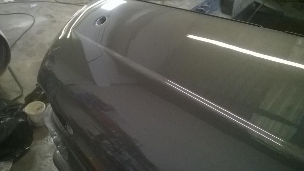

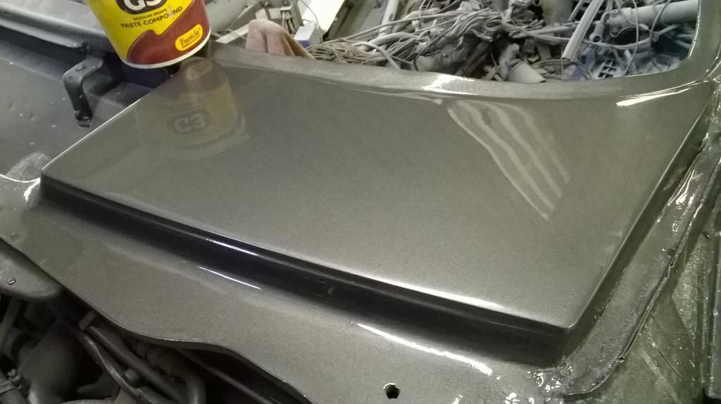

been ill... getting better but managed to do a bit of buffing
it will turn out quite nice i think.

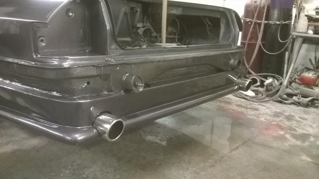

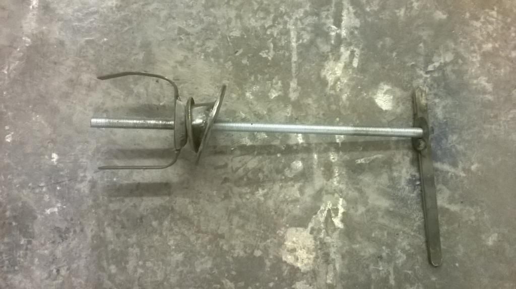

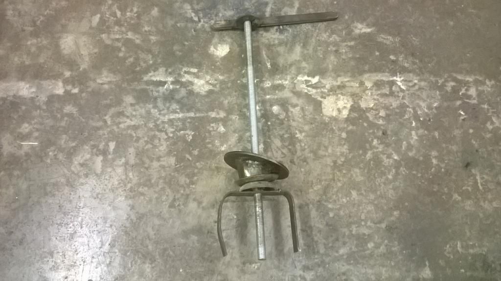

also had a play with front suspension because there was no travel at all on drivers side. this was the side i had stripped to repair the section of subframe. had a ball ache stripping out the spring even worse refitting. noticed it was 180 out so i made a tool...
it worked very well. better than the last one i made lol

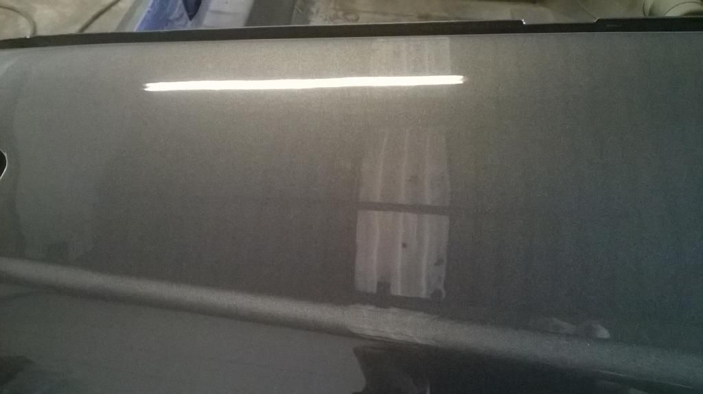

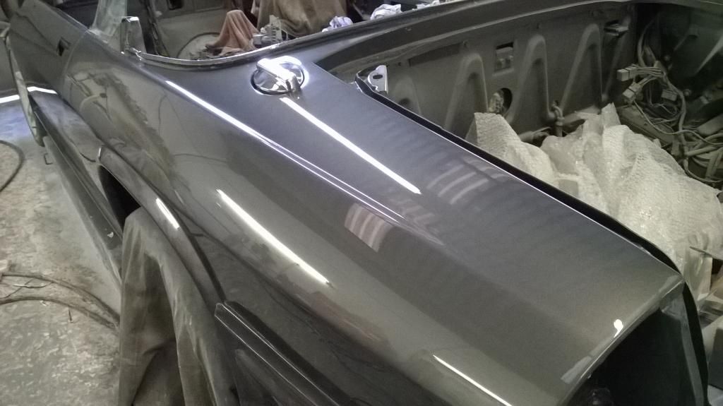

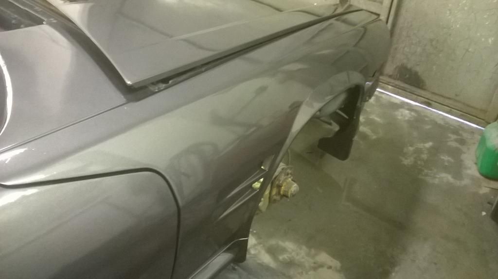

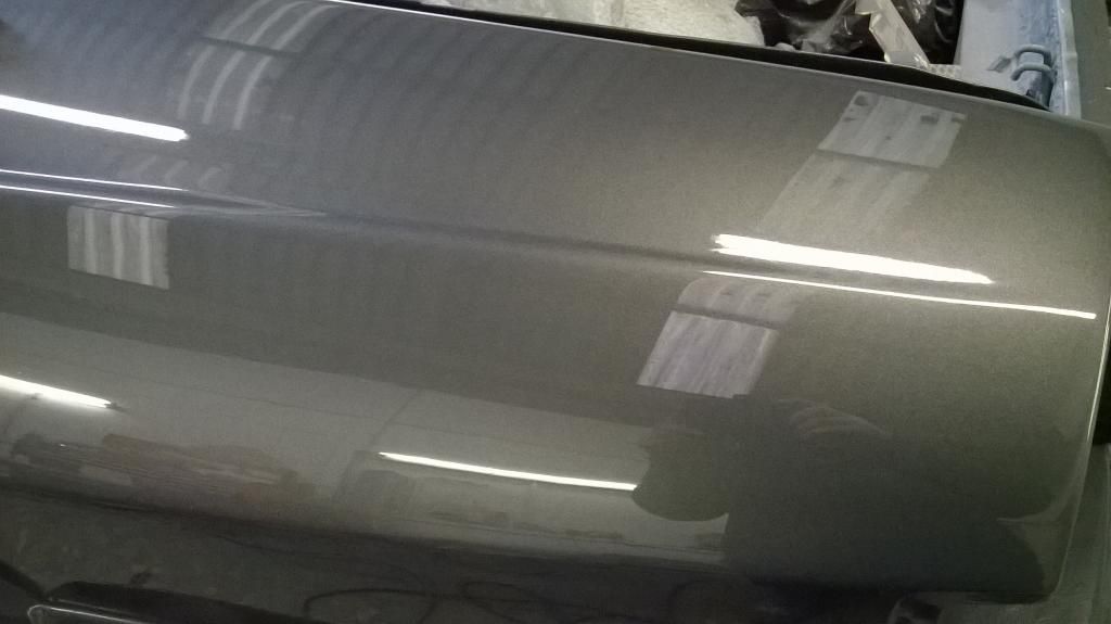

I sanded and buffed one panel today and I gotta say.....not impressed!
the finish is about half way where I want it to be but parts
of the panel are showing imperfections.
i asked a mate to look to see if he could see anything? he
couldn't!
i gave him another scenario...
you're about to pay 50k for this now can you see anything?
he found what I had spotted.
you cant see it in the pics, you have to be moving the
reflections round in the panel which is how I do it. it
takes longer uses more paint and clear but it's the only
surefire way to get something perfect!

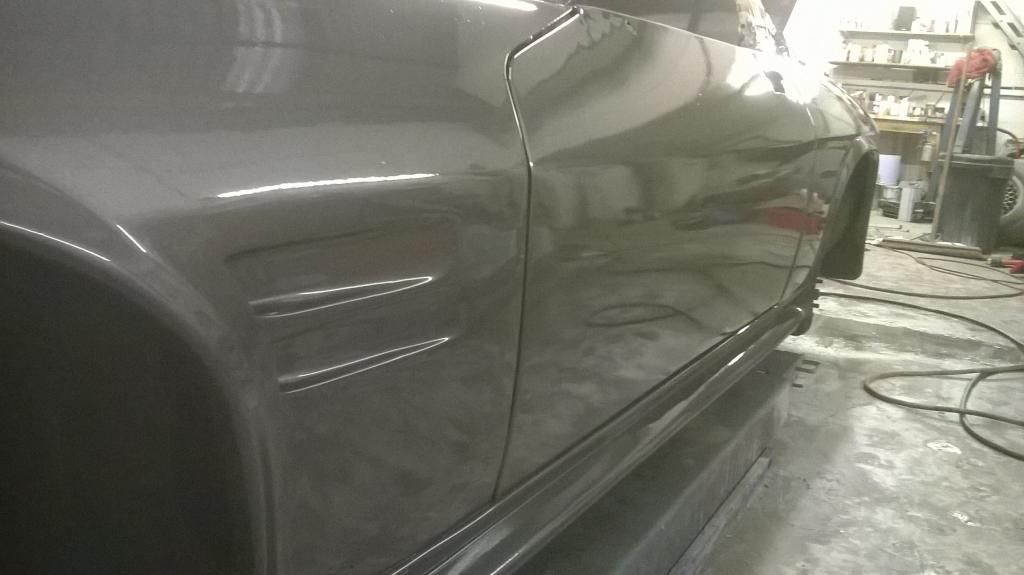

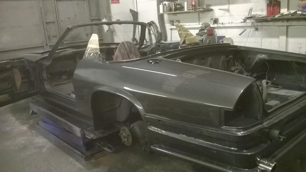

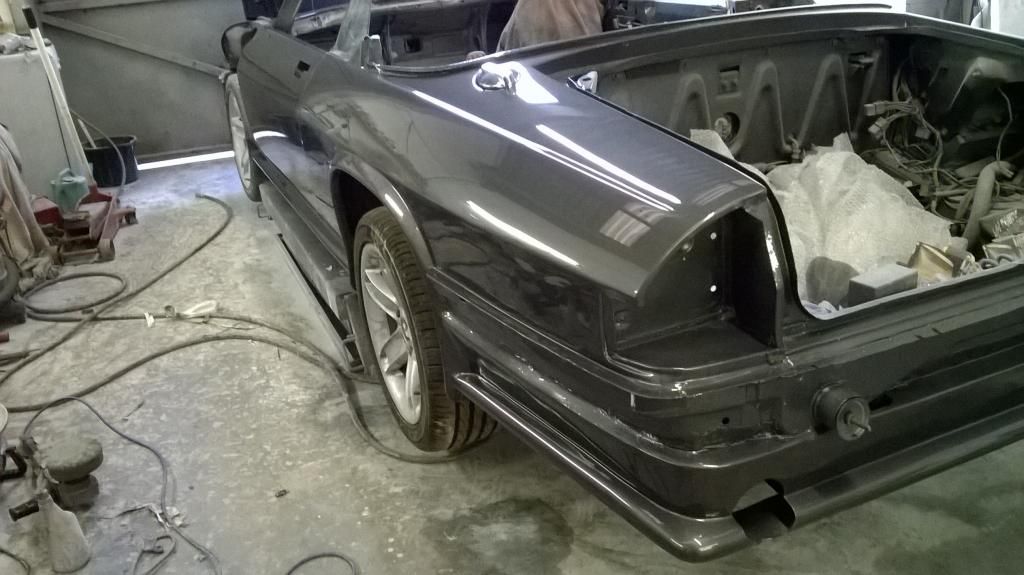

happy with the outcome so far.

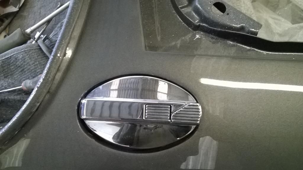

my OCD is taking a turn for the worse i can't get this to sit center lol
this makes me happy, this wasn't even present when i got the car
