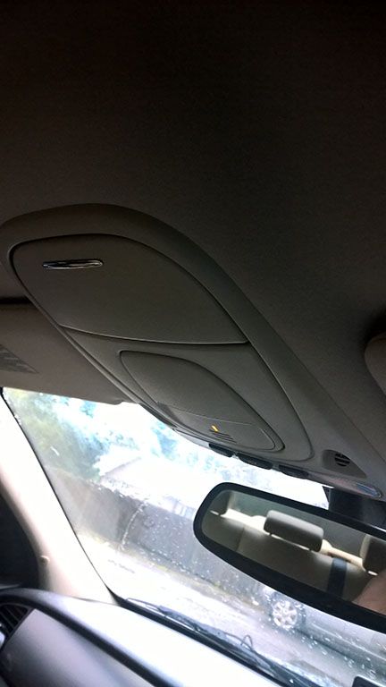

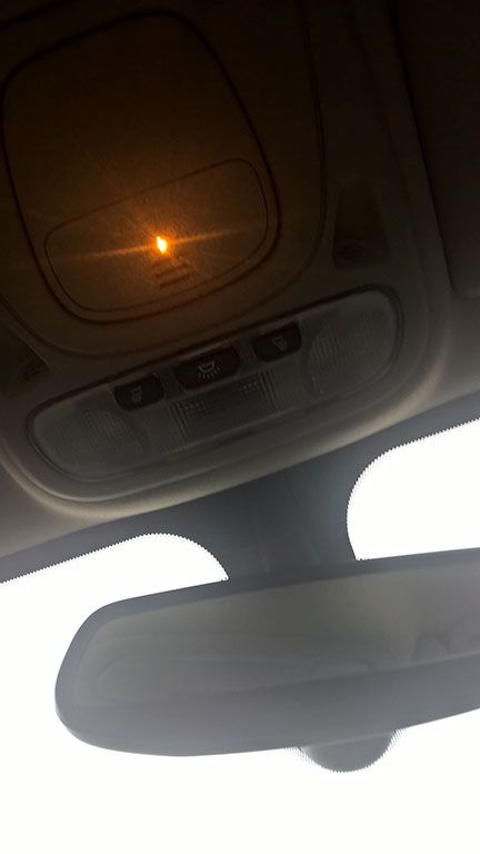

Well I just found out that I have power folding mirrors one less retrofit to do.  But how would I be able to easily tell if mine as blue tooth fitted ?
Thanks
There should be a microphone pod fitted to the headlining by the interior light console. If that isn't there then you don't have Bluetooth OR Jaguar Voice. If it is there, then use your phone to detect Bluetooth. If it sees a Bluetooth contact called "Jaguar", you have Bluetooth.
Earlier models had the microphone hidden in the overhead console but yours should have the separate one.
Do you have the Sat Nav display?
no oem sat nav, will have a look in the morning for the mic.
Doesn't look like I have the mic, so what parts do I need please and what should I expect to pay.  Thanks for the help.
You'll need the bluetooth module, telephone module and microphone John.
You'll also need to modify the D2B fibre optic cable but that's easier than it sounds. Takes about 10 minutes.
Have you got any modules in the boot on the left hand side?
PM me your e-mail address and I'll send you the installation instructions regarding the retro-fit.
Did you scan for a Bluetooth installation with your phone? I should give it a try just in case you have the older type of concealed microphone.
Otherwise, if I recall correctly, I bought all the components required for £75 last time I did this retro-fit.
