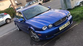

Hey. If your still looking, I have a 2.2 diesel manual sport. 58 reg so full width chrome on the boot, spoiler too. driving on 18" Jaguar alloys in the best colour of blue. 35-60mpg if you can stick to 56mph on cruise control. I highly recomend the car.
