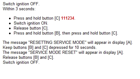

Hi all i have just had a service on my 2009 xtype 2.2 the garage guys are usually great but even they are stumped how do you reset the service required message that comes up on start up
Ok Just found this from an older forum, so if anyone else needs it here you are!  thanks Joe will go and try it
Yes, this is the way to delete the service message.

Thanks Peter but unfortunately this fix didn't work any suggestions appreciated

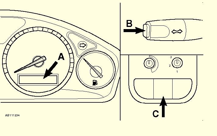

It definitely works. I did it last week. Took me 10 attempts, as you have to go really quickly. Also, instead of 10 seconds, I held it for 60.
OK i've tried it my! My mechanic has tried it! and its so frustrating, so I guess from the previous comment ill keep trying then. Thank for the reply Amanda & Peter
 will let you know how many attempts or you may not hear from me at all as ill still be in the car!
Cheers

I think you should try this fix if not just to see if it works for you

I have used this fix about 5 times and it always works.  But when the car has just had a service I think that the system is getting things wrong.  I won't be driving much in the next few days due to a damaged left hand which is now in a splint, but my mechanic is fitting a new wing mirror on the 26th and he will use his scanner to rub it out.
