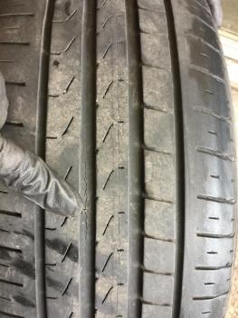

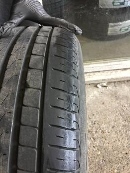

Hi, new to the club, I’ve got a 2010 3.0D and it has a slight vibration from around 60 to 75, garage has changed lots of front end parts and I’ve just fitted two new tyres but the vibration is still there. Reading the posts above this seems to be a comment fault, I’ve read this could be drive train related, not sure if there is any truth in this.
  • 4 years later...
@abiltcliffe, what was the outcome after all? I have an XF-S X250 2009 and I have exactly same issue now and it makes me mad! Like you I decided to leave it for a while and wait until it get bad so finally could tell what is the issue, yet that does not happened.
So far I have been at Grange Barnet where they did full car check and replaced anything that needed to be replaced (it was in 2022), then in 2023 replaced front wishbones. 2023/2024 replaced all tyres, alloys (twice - 1 set of 18's with winter tyres just for a try, then new 20's with summer Michelin Pilot Sport 5 brand new tyres). Wheel balance done each time on Elite Hunter machine. Last month I had replaced front passenger wheel hub as it was marked by Independent as faulty. Car has 135k miles on the clock. Been to Jaguar Grange, two Independent Specs, two ATS's - none of which see an issue with suspension. Recently did allignment check and the rear cambers are slightly out of the limit (negative values). Yet apparently there is no setting on them and if those are out of limit, it points towards suspension - which once again, nobody see an issue with! It literally drive me nuts as the car is wobbly/bouncy. It is not related to speed but the road quality. Even at slow speeds, when there is uneven road I can feel it all bumpy. On motorway if I drive with constant speed, the vibration can develop from time to time. All the mechanics give me "maybe" guesses and all are rather expensive - propshaft, driveshaft, differential, any other wheel hub. But no one can pin point where the issue really is. I am tired of replacing part by part and seeing no results.

Like I have mentioned, I tried three different sets of alloys and three different sets of tyres. Each set was balanced, tyres were also checked. One set of alloys was bent but replacing it with a perfectly round set did not change the drive feel. I had Dunlop's, Pirelli's and now Michelin's. Every single time there is no difference and car is still bumpy and wobbly. My bet is on the shocks yet the Specialists (I visited two plus two/three other garages), claim everything is OK with suspension. I am tired of replacing part by part with no improvement. Alloys and Tyres were tested on a different Jag XF and there was no issue, hence I am still convinced it is something with the suspension.
