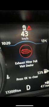

Dear Phil,
Can you please confirm that after the longer drive the red DPF error was gone? Or was it yellow/orange color error?
I had a   Red error: "Exhaust fillter full, visit dealer". I drove for 45 minute but it did not go away, did not do the regeneration. I had to take it to the garage shop to fix it.
