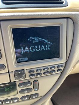

anyone has a DVD nav disc for the Jaguar S-type year 2001 ?
thanks
Would like to try if this system works. Anyone who has a nav disc ? S-type 3.0 V6 from 2001
