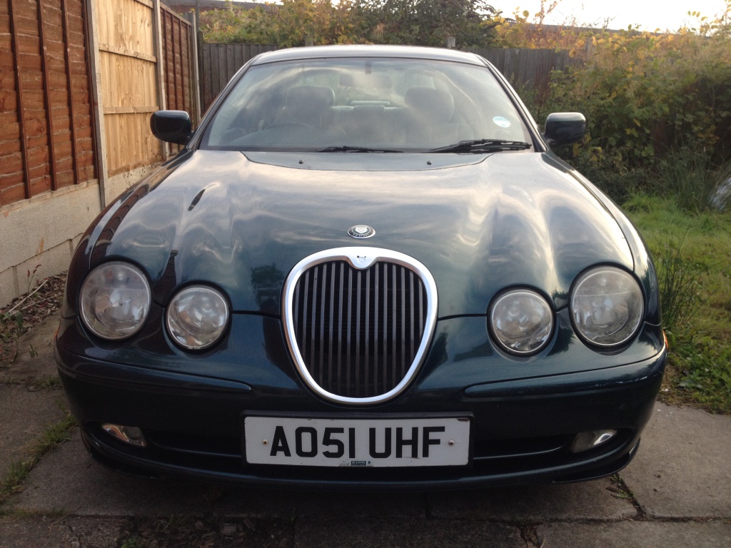

UPDATE:
Fox has fixed the bonnet however, in order to do so, they had to break through the original grill :(
At least they have put a replacement one on. not the same, and was not painted, so I sprayed it with what I had left from the wheels.
Temporary fix. Only looks good from a distance. :)
Also, now I have to find a badge for this one too...
