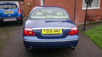

Purely for aesthetics.
Had them left over from my 3.0 petrol and the dealer I bought my 2.7d from painted the exhaust tips black:surprise:
not boy racerish at all
