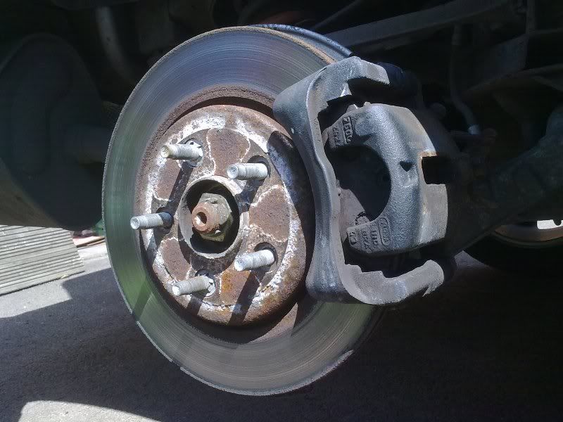

I was concerned that each of the wheels seemed to be rusted on the hub and had to be knocked off. I was a bit cautious at first as I was using the supplied jack and as a gentle thumb wasn't getting anywhere, in the end I had to give the wheels a couple of kicks to get them off. Obviously I changed from the supplied jack and brought out the trolley jack and axle stands.

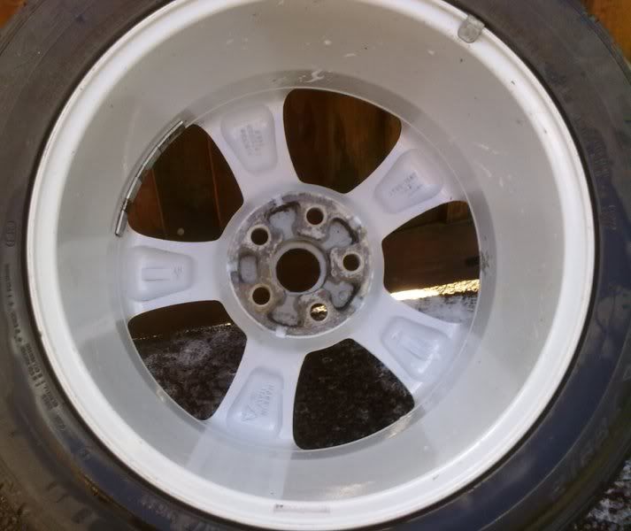

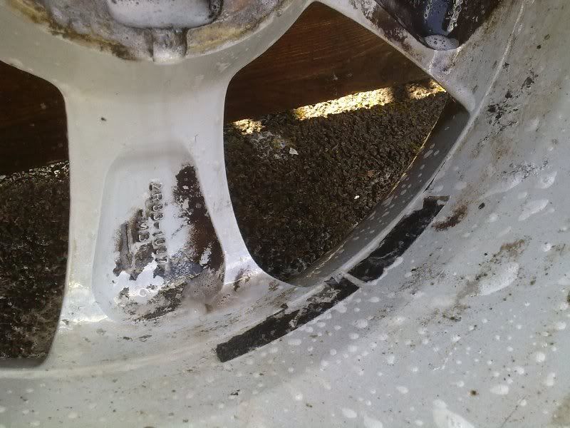

Wheel removed - light dirt, brake dust, tar, rust and adhesive residue on the inside.
On the other side, the hub is rusted with rust patches on the caliper
First wash with AG Shampoo, agitated with a car brush, the more stubborn stains/tar/rust/adhesive needs a bit more.....
With the use of AG Clean Tyre and some more agitation;
AG Tar Remover;
A small (brass) wire brush (for the rust);

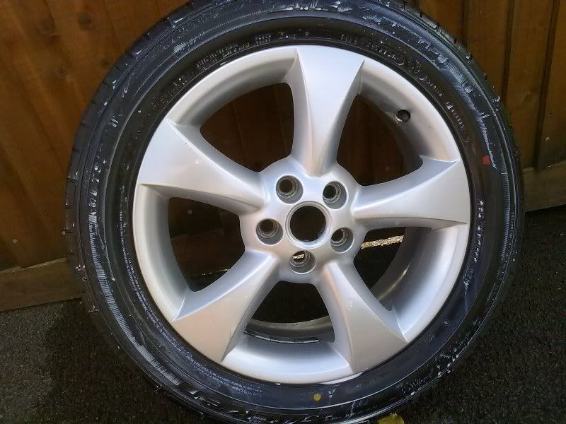

the results are pretty good.
The whole wheel rinsed off and a layer of AG Super Resin polish applied (inside and out).
To address the rust and sticking to the hub, a thin application of copper slip is applied where the two metals will meet.
Didn't want to put too much on, as I don't want to spend the next couple of days cleaning it off.

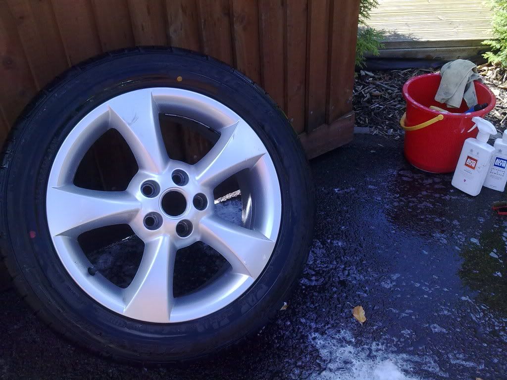

Clean wheel mmmm
AG Instant Tyre dressing applied and left to dry, time to turn my attention hub and brake.

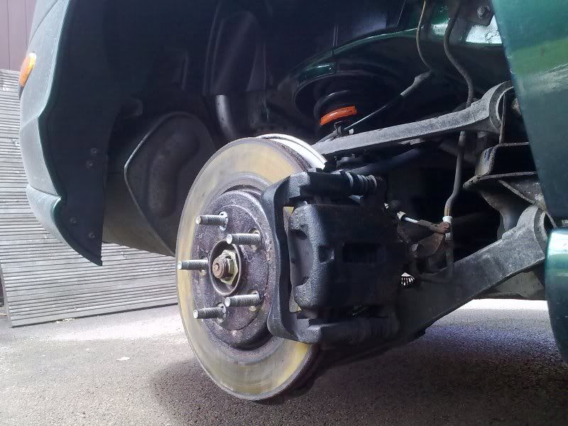

Hub and caliper cleaned as with the whole wheel arch;
Rust prevention applied to hub, allowed to dry;
Not enough time to paint calipers - perhaps next time?
Wheel back in place :D
A job well done
