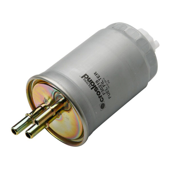

16 hours ago, JimC64 said:
Lisa, as far as I'm aware ( stand to be corrected ) I'm unsure if the fuel filter would throw a code, could be wrong, but......
at 100k miles and definitely if you're unsure it's cheap maintenance item to do
Various ones are available and everyone has their own favourite, so take your pic
Bosch £19.49
Mann £18.99
Crossland £13.49
all available from Eurocarparts, or you could try your dealer who will relieve you of considerably more probably, but......always worth asking the question at least.
Should look like this, see below....easy to change
Each to their own, but as a service I generally replace it every year to 18 months, its a cheap insurance basically
Your car has covered 100k miles, and an 08 so around 8 years old, you should be aware of the battery Lisa. Our cars are very sensitive to weak / old / failing batteries and can cause all sorts of issues ( not necessarily related to this event ) but weird things happen
Get your battery checked to see it's state of health....If it's original and depending on your usage, cold winter months etc really take their toll on it, certainly worth looking at / bearing in mind if you're keeping the car long term ( 2- 3 years or more )
Hope it helps?
Best
Jim
