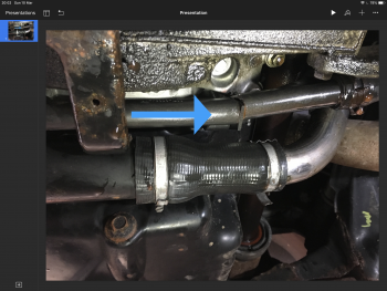

2 pipes/hoses are damaged. The long one running past the catalytic converters has a hole in it - there seems to be a clip missing to hold it up.
the other pipe is a solid piece that runs under the engine towards the radiator.
Hopefully someone will be able to help me identify them.
I have identified the long pipe that goes to the heater booster. I really need help with the pipe that I have arrowed . It sits beside the inter cooler pipe.
