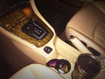

i have used Humbrol modlers enamal paint in the past, you can buy in Matt finish and blend with other-colours to get the correct colour to suit your plastic trim, I've found it to be the best solution for me.
Now here's the challenge , below is a pic of my centre console with a 2"sq  area that I've touched up with Humbrol, who can tell me where it is
cheers, Andrew
